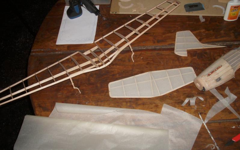

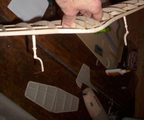

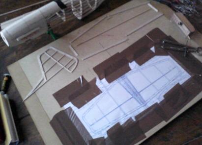

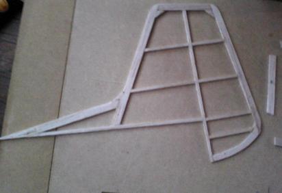

Re: Uruguayan Mustang F51-D
Příspěvek od Marcelo Pricoli » 24 srp 2011 00:20

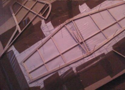

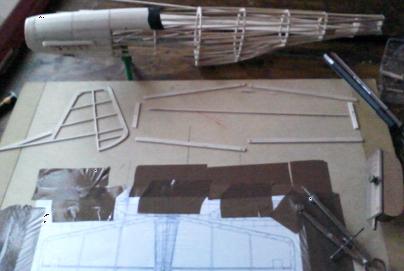

this is the tail surfaces build stages for my mustang p51d
EARL STAH MUSTANG P51 D TAIL STAGES 03.JPG (12.54 KiB) Zobrazeno 5503 x
EARL STAH MUSTANG P51 D TAIL STAGES 02.JPG (18.57 KiB) Zobrazeno 5503 x
EARL STAH MUSTANG P51 D TAIL STAGES 01.JPG (16.83 KiB) Zobrazeno 5503 x

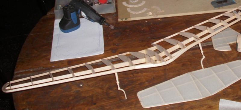

Příspěvek od Marcelo Pricoli » 24 srp 2011 00:24

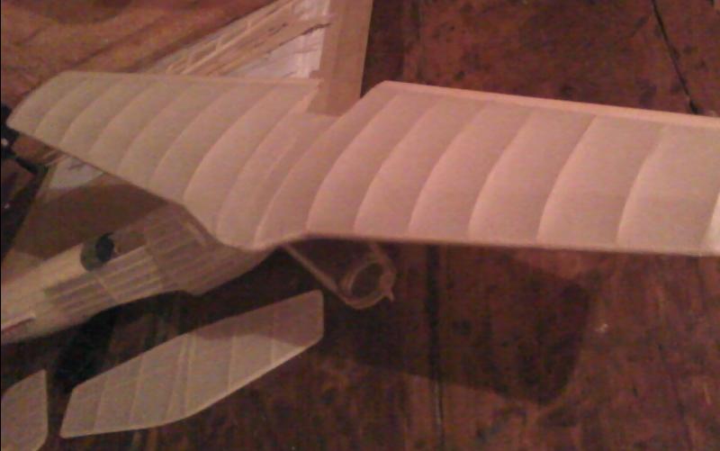

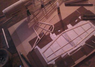

more from this stage!
EARL STAH MUSTANG P51 D TAIL STAGES 05.JPG (17.88 KiB) Zobrazeno 5503 x
EARL STAH MUSTANG P51 D TAIL STAGES 04.JPG (17.45 KiB) Zobrazeno 5503 x

i still used ciano to glue wood parts.whis find the "khanagom"glue here!but this label is unknow for all stores here.

Don´t wory, the glue named Kanagom is typical Czech product not sold in other countries and actually we are also using cyano to build balsa airframe.

What about "UHU Hart" ? It is very similar to Kanagom (maybe better as the glue does not shrink so much as Kanagom)

aha!!! i know UHU products! uhu hart is common here, but when dry, is not rigid.parts glued togheter moved, not a rigid attachmet -if use pure- may be the uhu hart is mixing with alcohol or thinner??? works better?mixing this way may be penetrate better in the wood and doing a better and strong attachment -saved weights too-???iam talkin about uhu hart in the yellow package -here is common- i know time ao a uhu "balsa wood" in clear blue packaging label, but i dont find this particular -the clear blue packaging- cement anymore.i trying with the uhu hart again.

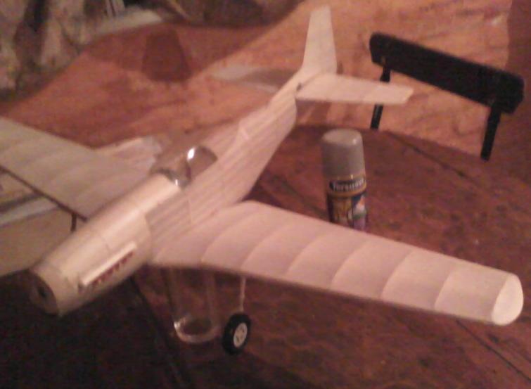

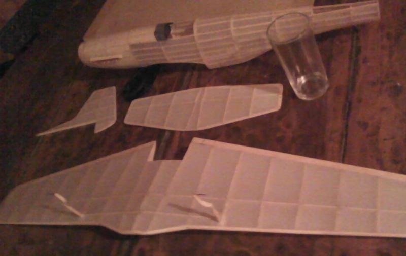

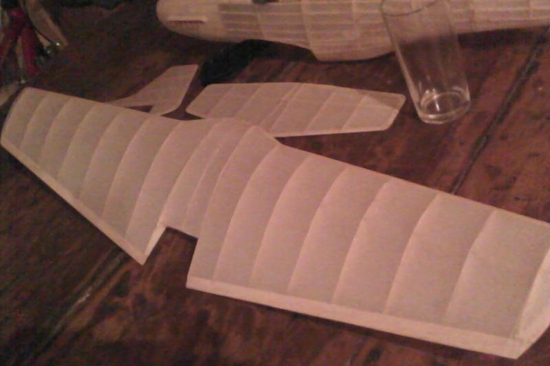

Příspěvek od Marcelo Pricoli » 09 zář 2011 13:04

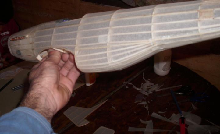

this is some pictures of the stages of covering, the entire model is shrinking with water spray and doped with 50/50thinner mixing.
the LG is .06 steel wire and covered with sheet of balsa, rounded and shaped.

Příspěvek od Marcelo Pricoli » 09 zář 2011 13:08

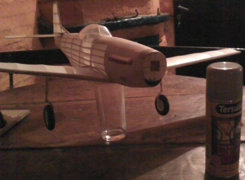

the model was painting with "metal" grey aluminium spray to doing better appereance.
i do not find detail of the "radiogoniometro" antenna, i searching yet

need to fing "gun - metal" paint for the lg !!!

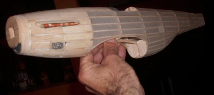

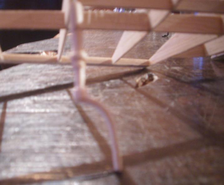

Příspěvek od Marcelo Pricoli » 16 zář 2011 12:00

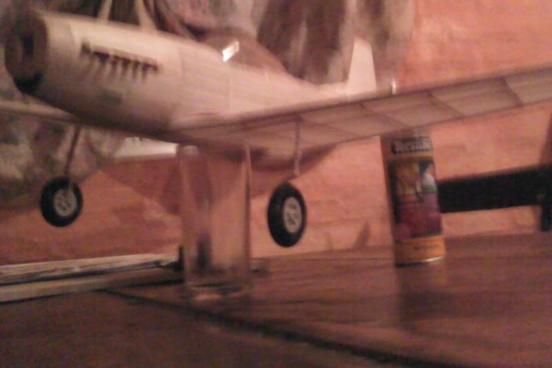

covering stages for my mustang f51 d i need to find a good sketches of the goniometer antenna loated in the rear part of fuselaje, all parts needed tp finiching the ship are doing with soft balsa blocks, the wheels in the pictures are of the mustang but is located for the picture only(come from a old mustang kit from guillow)my wheel are doing with balsa, i searching for good sketches of the wheels, cooler first part, etc.the finishing after dope, is doing with spray ename grey "peerles" but not sure if this color doing a nake metal skin, mmmmm, need test this paint first.

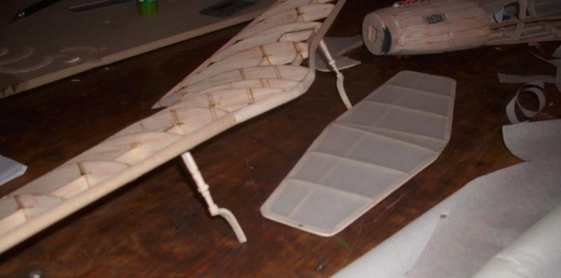

more pictures from the set.
iam reading the article of Mr. Earl Stahl and i ask me what type of rubber use Earl in this past years, and thinking in a comparaisson with the actually rubber in the market, he use and indicate a big amount of rubber for his designs, i tinking reduce at the middle the quantity, as an example, my stinson 125(another one from earl stahl plans)fly with the half of rubber indicated by Mr. stahl.but is hight wing model and in consecuense is much more stable in the air than a low wing model.
